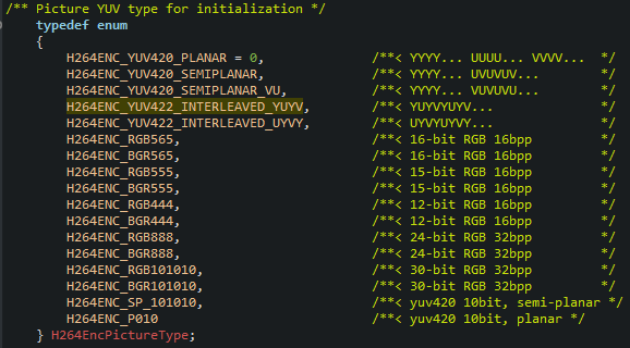

1. What is the input data format of the H.264 encoder (VENC)?
   Is it receiving YUV420/NV12 from DCMIPP, or some other format?

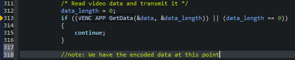

2. Is there an API in the VENC example that allows access to the encoded H.264 bitstream buffer
   (pointer + size), before it is sent through the RTSP server?

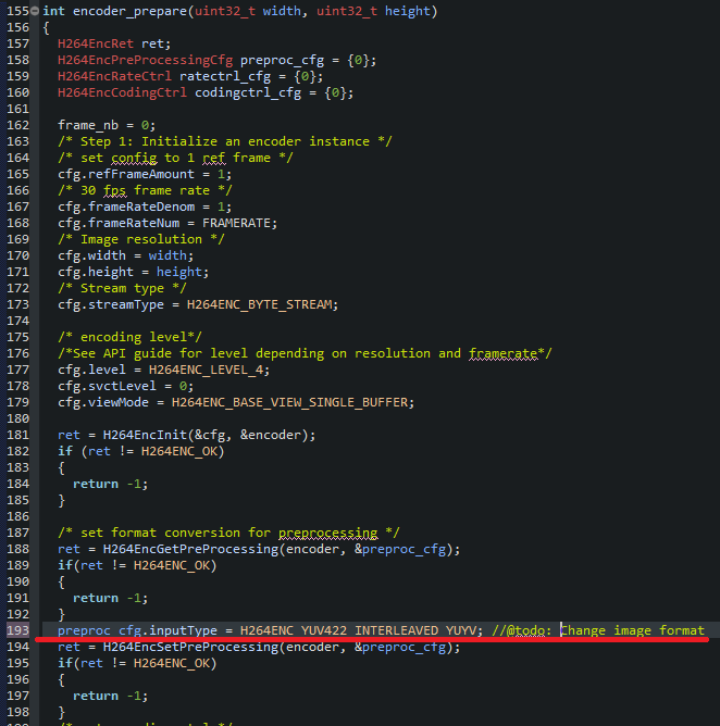

1. The VENC input format can be adjusted in the `encoder_prepare()` function:
Options of input types:
This would be based on your camera output of course. For debugging perhaps extract the preprocessed frame memory and view to verify it matches the expected encoder format.
2. The easiest would be to capture the data similar to how its done in `app_rtsp_over_rtp.c`. After the VENC_APP_GetData() function, the data is available at this point. (Don't forget to include the H264 headers in your stream).
