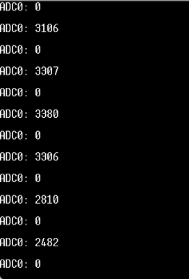

Im new to STM and trying to use ADC with DMA in circular mode but the value of my ADC remains at 0. I also tested it with Polling, which works.
ICache and DCache : Enable
void menu_adc(void)
uint32_t adc_buffer[1];
uint16_t adc0;
uint8_t flag_adc;
void menu_adc(void)
	    char buf[30];
    	HAL_ADC_Start_DMA(&hadc1, adc_buffer, 1);
	    while(1){
	    	if (flag_adc == 1)
	    		flag_adc =0;
				int len = snprintf(buf, sizeof(buf), "ADC0: %u\r\n", adc0);
				HAL_UART_Transmit(&huart1, (uint8_t*)buf, len, HAL_MAX_DELAY);
				HAL_Delay(200);
	        if (HAL_ADC_PollForConversion(&hadc1, 100) == HAL_OK)
	            uint32_t adc_value = HAL_ADC_GetValue(&hadc1);
	            int len = snprintf(buf, sizeof(buf), "ADC0: %lu\r\n", adc_value);
void HAL_ADC_ConvCpltCallback(ADC_HandleTypeDef* hadc)
    if(hadc->Instance == ADC1)
        adc0 = adc_buffer[0]; // ADC1_INP0
        flag_adc = 1;
Results:
I am also attaching the IOC so that you can look at the configuration of the ADC and DMA.

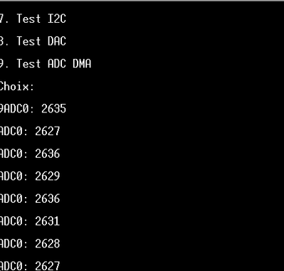

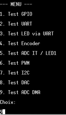

Ok thank you, that worked, here my new Callback :
        SCB_InvalidateDCache_by_Addr((uint32_t*)adc_buffer, sizeof(adc_buffer));
        adc0_dma = adc_buffer[0]; // ADC1_INP0
        flag_adc = 1;
    if(hadc->Instance == ADC2)
    	adc0_it = HAL_ADC_GetValue(hadc);
    	flag_adc = 1;
void adc_dma(void)
    char buf[30];
    while(1){
    	if (flag_adc == 1)
    		flag_adc =0;
			int len = snprintf(buf, sizeof(buf), "ADC0: %u\r\n", adc0_dma);
Result :
Have a good day
