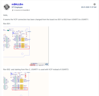

It seems the VCP connection has been changed from the board rev B01 to B02 from USART3 to USART1:
Rev B01:
Rev B02. and starting from Rev 2, USART1 is used with VCP instead of USART3:
So check the revision of your board:
If B02 or later you need to use USART1. I've attached a project where USART1 is used and Tx and Rx are looped back and the Rx callback is continuously called each character is received.
Hope that helps.

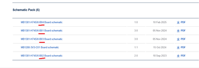

Thanks for that information I will try it now but I checked that you said and I have "B03". I was using revision "B01" as you mentioned. How can I find "B03" or I can still use "B02" ?

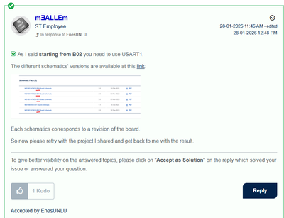

As I said starting from B02 you need to use USART1.
The different schematics' versions are available at this link:
Each schematics corresponds to a revision of the board.
So now please retry with the project I shared and get back to me with the result.
