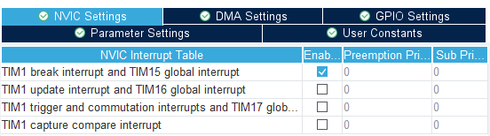

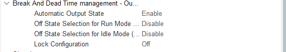

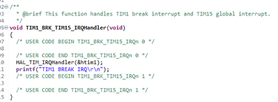

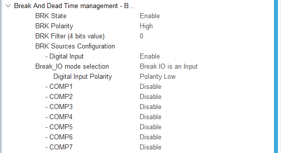

Hi All,
I'm using STM32G4 with TIM1 for motor control. The BKIN hardware protection works correctly - when I pull the BKIN pin (PB10) low, the motor stops, and when high, it runs again with AOE enabled. However, the break interrupt never fires and HAL_TIMEx_BreakCallback is never called. I've verified that TIM1_BRK_TIM15_IRQHandler exists in stm32g4xx_it.c, NVIC is enabled. The break flag never gets set even though BKIN is functioning. What could prevent the break flag from being set while the hardware break feature still works?
I want to print diagnostic using BKIN callback routing but it doesn't work.
I've attached IOC timer configurations.
Best regards

Hey all,
I think I understand the problem.
HAL_TIMEx_PWMN_Start_IT function also enables the break interrupt so I think I need to manually enable the break interrupt when using the TIM_PWM_START_IT function.

Does a breakpoint in TIM1_BRK_TIM15_IRQHandler ever get hit?
Saket_Om
Hello @batuhanky
Could you please check if the break interrupt (BIE) is enabled in the TIMx_DIER register?
Saket_Om
Hey @TDK
No it doesn't get hit but there is an interrupt callback.
When I ground the BKIN pin, the motor stops but printf does not work.
Hey @Saket_Om ,
No, BIE is not set, but when I manually enable the BIE bit, the callback works. What could be the reason for this?
TIM1->DIER |= (1 << 7);
