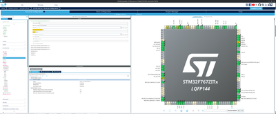

I'm trying to use an LCD with ILI9341 chip. I've connected all pins to the LCD and I've set in CubeMX the FMC like this:
But when I tried to run the program, all calls from main.c is calling MX_FMC_Init(); then is going in this function:

And I can't go over this error. I don't understand what is wrong with the FMC configuration.
Can somebody give me a help?

Most probably you have the MPU default configuration enabled which disables the access to all external memory regions:
static void MPU_Config(void)
MPU_Region_InitTypeDef MPU_InitStruct;
/* Disable the MPU */
HAL_MPU_Disable();
/* Configure the MPU as Strongly ordered for not defined regions */
MPU_InitStruct.Enable = MPU_REGION_ENABLE;
MPU_InitStruct.BaseAddress = 0x00;
MPU_InitStruct.Size = MPU_REGION_SIZE_4GB;
MPU_InitStruct.AccessPermission = MPU_REGION_NO_ACCESS;
MPU_InitStruct.IsBufferable = MPU_ACCESS_NOT_BUFFERABLE;
MPU_InitStruct.IsCacheable = MPU_ACCESS_NOT_CACHEABLE;
MPU_InitStruct.IsShareable = MPU_ACCESS_SHAREABLE;
MPU_InitStruct.Number = MPU_REGION_NUMBER0;
MPU_InitStruct.TypeExtField = MPU_TEX_LEVEL0;
MPU_InitStruct.SubRegionDisable = 0x87;
MPU_InitStruct.DisableExec = MPU_INSTRUCTION_ACCESS_DISABLE;
HAL_MPU_ConfigRegion(&MPU_InitStruct);
/* Enable the MPU */
HAL_MPU_Enable(MPU_PRIVILEGED_DEFAULT);
That default MPU configuration is to prevent the CM7 speculative access to the non configured memories especially the external ones (explanation here). So you need to configure another MPU memory region to enable the access to the LCD.

2025-12-16 7:21 AM
Thanks. After I disabled MPU, I could able to boot my firmware. I wall check the link you gave me.
2025-12-16 7:28 AM - edited 2025-12-16 7:29 AM
Better to add another MPU region for LCD memory range to enable the CPU access instead of disabling the background MPU config.
