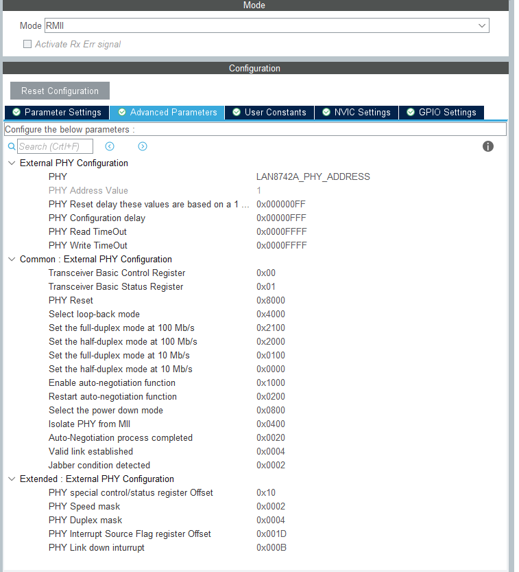

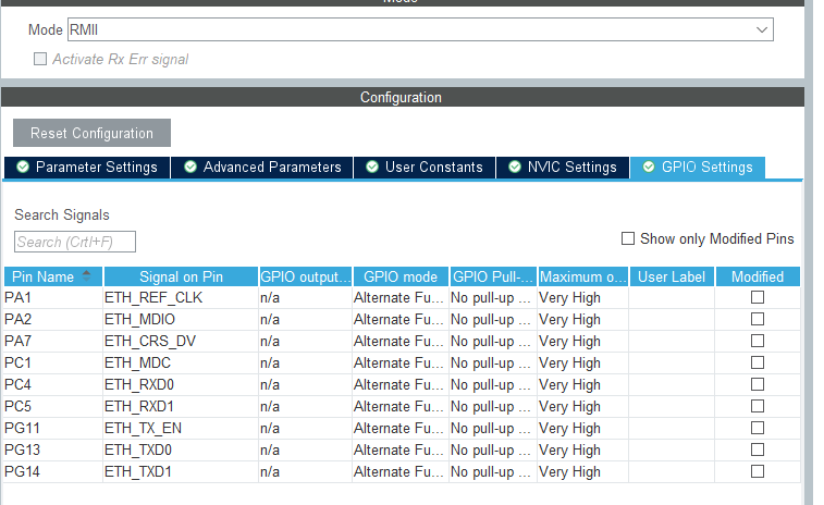

So I have this STM32F750 Discovery board with RMII Ethernet connection and I have another H745 Discovery with MII Ethernet.
I am trying the same project in both of them, and it's working in MII but not in RMII.
I tried every possible solution I can think of, like the MPU configurations, different memory locations for the DMA Descriptors, with/without RTOS, but never got it working with the RMII.
The code executes fine, the Tx Buffer is updating fine, but somehow the connection is not working.
Solved! Go to Solution.

‎2021-06-22 11:28 PM
Got it Working.
In Ethernet configuration, PHY Address should be set to 0.
