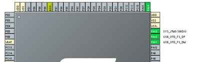

I managed to create a Basic STM32 Cube Project for this controller. (STM32F407VET6)

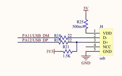

From the Schematic on STM32base website, I see PA12, PA11 connected to the USB Connector...

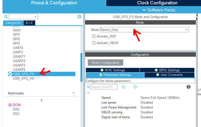

I have enabled USB_OTG_FS which corresponds to PA11, PA12 in hardware and schematic.

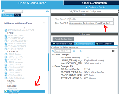

And further, under "Middleware and Software Packs" I have selected "Communication Device Class (Virtual Port Com)"

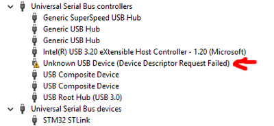

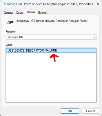

However the USB COM Port is giving hell of a lot of trouble, with Windows being unable to get even the Device Descriptor from the board!
What am I doing wrong? Any step I have missed or any configuration I have done wrongly?

CubeMX settings look okay. Ensure HSE_VALUE is set to 8000000 on the clock page.
R21 should not be present. May or may not be affecting things. The chip has an internal pullup for USB.
Yes, this I had noticed on STM32base website and removed it before starting
