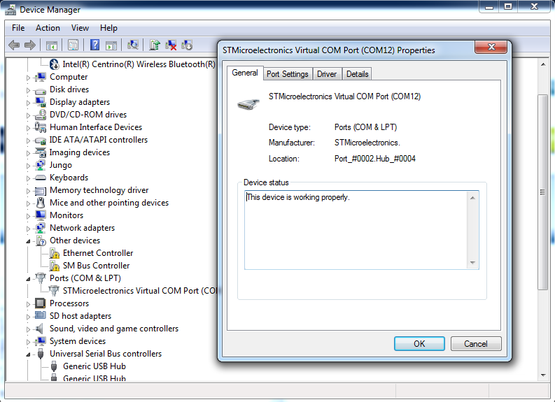

aydnouz
Posted on February 25, 2014 at 17:25
i guess it does, im not sure how can i understand that. But here it looks okay:

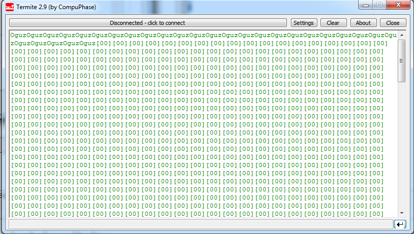

Device Manager: 0690X00000605XnQAI.png Additionally, i add some piece of code in main.c:
UserToPMABufferCopy((unsigned
char
*)ozee, INT_IN_TX_ADDRESS, Send_length);
SetEPTxCount(ENDP1, Send_length);
SetEPTxValid(ENDP1);
When i did that it sends data over USB, but after some data sent to PC it sending bunch of zeros like this: 0690X00000605RqQAI.png I'm guessing this is cuz of buffer size. But still im unable to use usbd_cdc_vcp.c andusbd_cdc_core.c to send data.
chen
Posted on February 26, 2014 at 15:03
Hi
OK, so the USB stack for the most part is working OK.
It enumerates and data can be transferred.
From the symptoms you describe, it sounds like the code in
usb_cdc_vcp.c is not doing what it is suppose to do.
The buffer 'APP_Rx_Buffer[]' should contain the data to send to the host.
It uses a pointer 'APP_Rx_ptr_in' should point to the end of the buffer when you have inserted what you want to transmit.
How does it work - go search for it in the code and figure it out!
Incidentally, the code as provided uses the same buffer to get data from the host.
I did not like that, so I created a separate buffer for that in my code.
