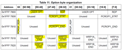

It is not published, but I suspect the OB are set on an internal flash page which is not accessible to the user. As with programming any flash, it is first erased entirely and then programmed. Presumably, changing any option bit could cause others to be corrupt if power gets reset.
Edit: actually, yes this is stated explicitly in the RM:

If a flash operation (non-option bytes) is interrupted, the option bytes should not be being modified. Only on option byte operations is this a possibility. So I don't think the code you posted could cause this.
That said, there are a number of threads over the years with issues like this claiming that the MCU is setting RDP=0xFF, but in my opinion none of these users actually posted very convincing evidence that the chip was to blame.
I would be interested to hear if the entire option byte section was erased, or if it was programmed with valid values (complementary values are the inverse of the real ones).

This is what I understood based on your clarification. If we perform memory operations other than the option bytes in shaky/low power, then MCU won't necessarily set the RDP. It comes into the picture only when something goes wrong during OB configuration. Please correct me if I'm wrong.
I've attached 2 screenshots where we are clearing the IWDG_STOP user OB flag. These operations are in the main function right when the MCU initialization happens. According to your clarification while performing these sequences there are chances to set RDP if anything goes wrong. Can you please confirm?
Also, the reason why we suspect on MCU chip to set the RDP rather than the code bug is that neither throughout this operation sequence nor in the whole software code did we touch OPTIONBYTE_RDP flag but instead used the OPTIONBYTE_USER flag. Do you think OPTIONBYTE_USER configuration can indirectly corrupt OPTIONBYTE_RDP?
For your knowledge, at the time of this issue, the entire option byte section was erased.
Correct. Regular flash operations will not affect option bytes.
Correct.
Absolutely. Whenever ANY option byte is set, the entire option byte area is erased (including RDP and whatever else is in there), then reprogrammed. At the hardware level, they cannot be modified one at a time. See the excerpt above from the reference manual.
Thanks. This lines up with what we think is happening--power loss during OB programming.
It's best to avoid writing to OB at all during production, if it can be avoided. Not sure if your particular situation, of course, but it seems reasonable to either always or never disable IWDG in stop mode.
