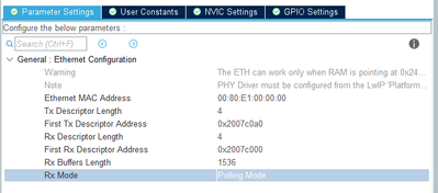

ETH Configuration:

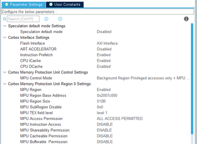

MPU Config:

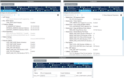

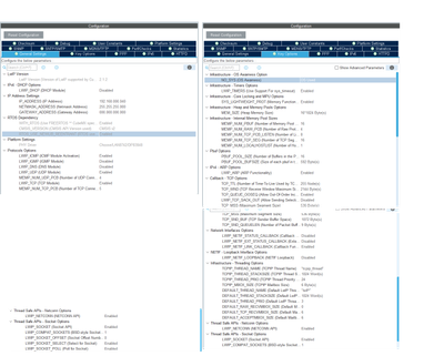

lwIP Config:

ETH Changes:
RX Mode: Interrupt Mode
NVIC Enabled Ethernet global interrupt preemption priority 5

lwIP some of the settings changed, it enabled OS-Mode for lwIP. (I haven't actively changed any):
WITH_RTOS (Use FREERTOS ** CubeMX specific **): Enabled
CMSIS_VERSION (CMSIS API Version used): CMSIS v2
RTOS_USE_NEWLIB_REENTRANT (RTOS used - 1): Enabled
NO_SYS (OS Awarness): OS Used
