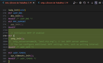

I really need it to be SNTP. However, I am facing difficulties, I am not familiar with the LwIP stack.
I tried some ways, for example: https://community.st.com/t5/stm32cubeide-mcus/lwip-sntp-what-does-it-actually-do/td-p/319642/page/2, where it was cited by @Piranha: https://stackoverflow.com/questions/61932743/how-does-the-sntp-app-of-the-lwip-component-set-the-time-it-receives. When I run this example the code crashes. I don't know how to continue, can you help me?
‎2024-05-07 9:48 AM

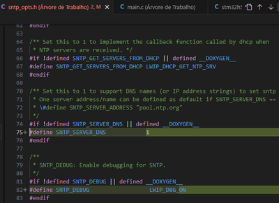

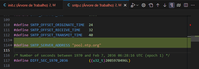

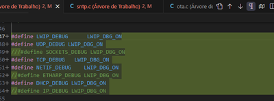

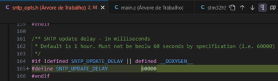

Here are some changes I made to the code in an attempt to implement SNTP:
File sntp.c:
File init.c
File sntp_opts.h
File lwipopts_freertos.h

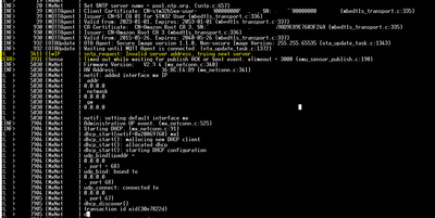

When running the code, I see the following log:

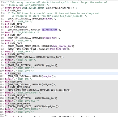

I noticed that when I debug the code, I get stuck on the following:
It's possible that this issue is related to this struct, however, I'm still investigating.
