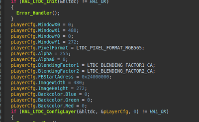

HI all i have been working with LTDC to drive an external RGB parallel display . i made it working by placing the framebuffer inside internal RAM . i got output with good update speed. but when i try to incoperate  FREERTOS with this project the output is gone . any one encountered such issues like this , any solution for this now? ;)

Hi guys thanks for the response , right now all i know is that LTDC is being initialized , beacuse in my code
starting address of internal RAM is given to LTDC and LTDC seems to read from the RAM , before RTOS i get full display output, but after output i get this scrambled red color on the screen , so without LTDC or clock signal i wouldn't have got anything on the display. so my assumption is that something is happeing with priority timing or my framebuffer is being scrambled somehow . whats your thoughts or ideas.

Still not  show 0x24000000 and framebuffer ... LTDC
b1aze
This is my linker script and i declared my framebuffer like this in main.c file
__attribute__((section(".framebuffer"),aligned(32))) uint16_t framebuffer[LCD_WIDTH * LCD_HEIGHT];
lv_color_t lvgl_buf[LCD_WIDTH * LVGL_BUF_SIZE];
 this is it nothing else i done for frmabuffer. and inside the LTDC i gave the RAM start address
pLayerCfg.FBStartAdress = 0x24000000;
