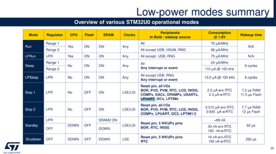

As per doc, page no 30, LPUART wakeup support only in STOP1 mode not in STOP2 mode. Is that correct ?
Also confuse it say clock source LSI/LSE support, does that mean it does not support HSI to wakeup ?
Edited: Yes it is also shown in the STOP2 mode, but again does it not support to wakeup at HSI clock ?

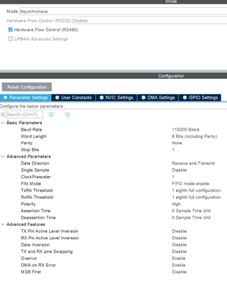

Using Custom board, HAL library, bare metal, STM32U0 series controller. Connected with 12 volt power supply and ST-Link Debugger for code dump.
npatil15
For more information using, HAL_UARTEx_ReceiveToIdle_IT()  for receiving data and transmitting using  HAL_UART_Transmit_IT() , So also need to understand does the ReceiveToIdeal support for wakeup event?
Actually I didnt get example code using ReceiveToIdeal() interrupt event.

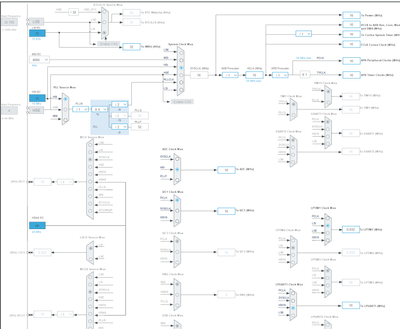

According to the reference manual STM32U0 series advanced Arm<Sup>®</Sup>-based 32-bit MCUs - Reference manual Figure 11. Clock tree, LSI is not an option for LPUART.
KnarfB
npatil15
Ohh yes, I was looking at wrong peripheral, I was using HSI.
I'm not sure why the it does not wakeup when rx has some data. Actually I have implement LPTIMER to wakeup at every 2 seconds, so that work perfectly but if RX has data then it dosnt wakeup.
So when lptimer wakeup then it found that RX buffer is filled then it process the RX frame and send the response, then again it wait for lptimer to wakeup again.
