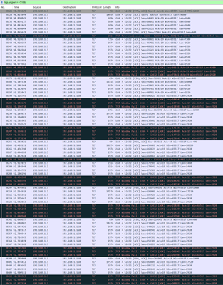

Hi Pavel,
Thanks for the suggestion, the following is a snapshot of the wireshark capture, please find the capture file attached:
There are three main issues in this application:
1. there are too many [TCP window FULL] reports which I don't know how to deal with
2. the maximal packet size is 19020 bytes sent from a server running from a PC, but the F767 client receives packets all at 1460 bytes, is there a way to increase it ?
3. the client application with F767 and LWIP causes network failure every 30 seconds
the server reports 10060 error "The connection has been dropped because of a network failure or because the peer system failed to respond" every 30 seconds
Regards
Chao
