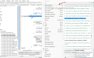

Hi @audio,
Sorry for the delay, i tried project generated with you .ioc and i see that UX_DEVICE_CLASS_AUDIO_FEEDBACK_SUPPORT is correctly generated in ux_user.h and correctly included in the project.
To test that you can compile generated code and then go to ux_device_class_audio_change.c file click with rigth button of your mouse on UX_DEVICE_CLASS_AUDIO_FEEDBACK_SUPPORT then go to declarection you can see that UX_DEVICE_CLASS_AUDIO_FEEDBACK_SUPPORT is defined in ux_user.h
