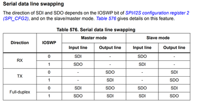

Look in rm of your chip, registers of the I2S : is there a swap bit ? (swap rx - tx ) .
from H743 :

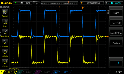

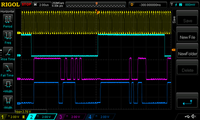

EDIT2: Here are two screenshots from oscilloscope:
1. Shows clock signal on master vs on slave (probes were connected on two ends of cable that connets I2S2 and I2S3 clocks)
ch1 (yellow) - slave clock
ch4 (blue) - master clock
2.  Shows data from microphones  
ch1 (yellow) clock
ch2 (turqoise) ws
ch3 (pink) i2s3 (slave) data
ch4 (blue) i2s2 (master) data
If I can provide you with more information, let me know.

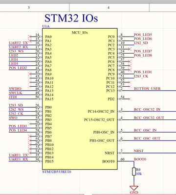

/**I2S2 GPIO Configuration
    PC2     ------> I2S2_SDI
    PB1     ------> I2S2_WS
    PB2     ------> I2S2_CK
    GPIO_InitStruct.Pin = GPIO_PIN_2;
    GPIO_InitStruct.Alternate = GPIO_AF5_SPI2;
    HAL_GPIO_Init(GPIOC, &GPIO_InitStruct);
    GPIO_InitStruct.Pin = GPIO_PIN_1;
    HAL_GPIO_Init(GPIOB, &GPIO_InitStruct);
    GPIO_InitStruct.Alternate = GPIO_AF6_SPI2;
/**I2S3 GPIO Configuration
    PA4     ------> I2S3_WS
    PB0     ------> I2S3_SDI
    PC10     ------> I2S3_CK
    GPIO_InitStruct.Pin = GPIO_PIN_4;
    GPIO_InitStruct.Alternate = GPIO_AF6_SPI3;
    HAL_GPIO_Init(GPIOA, &GPIO_InitStruct);
    GPIO_InitStruct.Pin = GPIO_PIN_0;
    GPIO_InitStruct.Alternate = GPIO_AF5_SPI3;
    GPIO_InitStruct.Pin = GPIO_PIN_10;
Also, after swapping master / slave roles in CubeMX, there is data on new master (previous slave), but there is no data on new slave (previous master). So I checked that I2S2 and I2S3 works while in master mode but none of them works as slave.
from H743 :
It worked, thank you very much!
I wonder why did Cube configure it differently?
For future generations, here you have functions that helped mi resolve the issue:
HAL_I2S_DisableIOSwap(master->i2s_handler);
HAL_I2S_EnableIOSwap(slave->i2s_handler);
