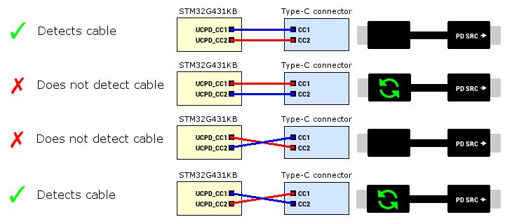

After getting help setting up a basic USB-C sink application in this thread, I can successfully detect cable attach/detach events through the relevant callbacks installed via ST USBPD API -- but only for a single cable orientation. The UCPD1 interrupt is not ever being triggered when reversing the Type-C plug.
To verify this is not an issue related to (all of) my USB-C cables or Type-C breakout interface, I've swapped the CC1/CC2 wires connecting the Type-C female receptacle to the MCU's CC1/CC2 GPIO pins. This ensures both CC1 and CC2 on the Type-C breakout can both be shown to function correctly. Therefore, I believe the issue must be isolated to just one of the CC GPIO interfaces on the MCU. I've drawn a diagram to clarify:
So when the CC wire in the USB-C cable is attached to the UCPD_CC2 GPIO pin, regardless of which CC wire was used on the Type-C breakout, the system fails to detect a connection.
Where should I look to figure out why only one orientation is being detected?

I think this is a known issue : the GPIO corresponding to the CC2 line has to be set into analog mode.
Can you check the file usbpd_cad_hw_if.c ?
Replace :
#if defined(MB1397) /* in case of eval G4 */
  /* Not needed on MB1397 */
#elif defined (USE_UNIBOARD) || defined(MB1428) || defined(MB1367) /* in case of Nucleo G4 */
  LL_GPIO_SetPinMode(GPIOB, LL_GPIO_PIN_4, LL_GPIO_MODE_ANALOG); /* PB4 mode = GP analog => CC2 */
#else
  LL_GPIO_SetPinMode(GPIOB, LL_GPIO_PIN_4, LL_GPIO_MODE_OUTPUT); /* PB4 mode = GP output => CC2 */
#endif
by :
/* Set by default UCPD1_CC1 & UCPD1_CC2 in analog mode */
  LL_GPIO_SetPinMode(GPIOB, LL_GPIO_PIN_6, LL_GPIO_MODE_ANALOG); /* PB6 mode = GP analog => CC1 */
  LL_GPIO_SetPinPull(GPIOB, LL_GPIO_PIN_6, LL_GPIO_PULL_NO);
This correction will be delivered officially next March.

Great, worked like a charm, thanks!
