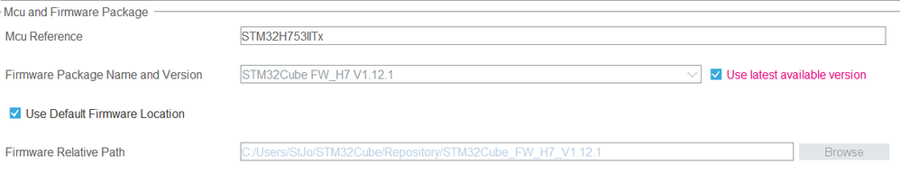

Hello @Saket_Om ,
I'm using the HAL files generated by CubeMx, but it seems to me that this file is outdated, because in the header contains year 2017. It appears to me it is the same as here:
https://github.com/STMicroelectronics/stm32h7xx-hal-driver/blob/master/Src/stm32h7xx_hal_nor.c
This is my CubeMx setup:
What can I do to use the latest version?

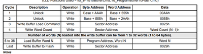

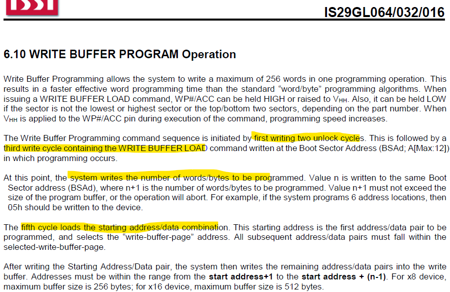

Hello @regjoe
After carefully reviewing the datasheets of the IS29GL064 and the S29GL128P, it is clear that the Write Buffer Programming method differs between these two devices.
The HAL_NOR_ProgramBuffer() function in the HAL driver is specifically designed to follow the programming cycle of the S29GL128P, as described in its datasheet.
Write Buffer Programming in S29GL128P
Therefore, using it directly with the IS29GL064, which employs a different buffer programming protocol, can lead to issues such as the memfault you encountered.
To leverage this feature with your IS29GL064 NOR flash , it would be necessary to implement a dedicated function that strictly follows the sequence and timing specified in the IS29GL064 datasheet.
WRITE BUFFER PROGRAM Operation in IS29GL064

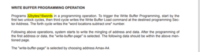

Hello @T_Hamdi
I agree that the statemachine drawings look different, but if you compare the text in the description, programming of both flash looks the same to me:
