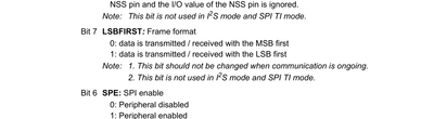

As you can see, I just start communication in SPI3_Start_Comm() and then in HAL_SPI_TxRxCpltCallback I prepare the bytes received at N-time to echo back at N+1-time.
What I get is the peripheral echoing back bytes at N+x-time, after three or four garbage results at first. If I print results from controller point of view this is what I get:
    COPI CIPO
0: 0000 XXXX (garbage)
1: 0000 XXXX (garbage)
2: 0800 XXXX (garbage)
3: 0800 XXXX (garbage)
4: 1000 0000 (N+3 echo back - it should be N+1 or 0800). Missing N = 0 echo
5: 1000 0800 (and so on...)
6: 1800 0800
7: 1800 1000
8: 2000 1000
9: 2000 1800
10: 2800 1800
11: 2800 2000
12: 3000 2000
13: 3000 2800
14: 3800 2800
15: 3800 3000
16: 0000 3000
17: 0000 3800
18: 0800 3800
19: 0800 0000
20: 1000 0000
Peripheral device is STM32F722ZE. Controller is a black box.

Thanks JW, replace controller is not an option. I have tried to debug but that's not been really helpful and confused me a bit, to be honest. Sure thing I must study more these peripherals I want to use.
It still seems strange to me that with 4-bit datasize it kind of works, but with inverted endianness:
   COPI CIPO
0: 0065 6538
1: 0065 6538
2: 0865 6500
3: 0865 6508
4: 1065 6508
5: 1065 6510
6: 1865 6510
7: 1865 6518
8: 2065 6518
9: 2065 6520
Both controller and peripheral devices should be little-endian.
waclawek.jan
It is always an option, when you want to gain an understanding of the details, to use some of the lowcost devboards, such as a Nucleo.
The SPI peripheral has no endianness.
You can configure it both ways.
