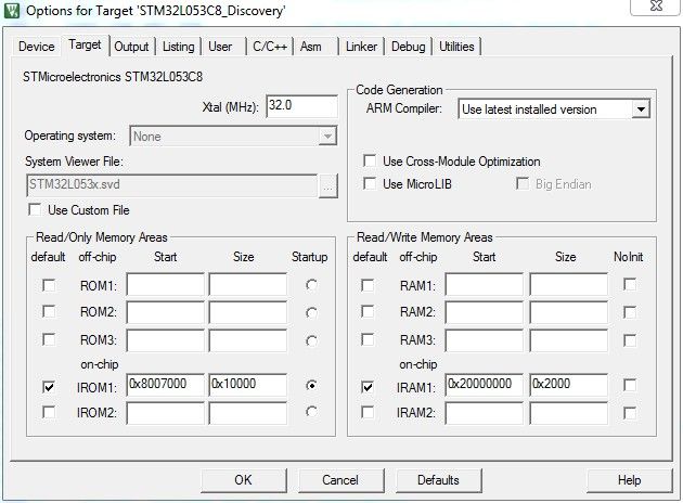

Iwant to generate a dfu file for my STM32L053C8-Discovery bord, but whatever I fill in the blanks in the DFU File Manager, when I choose a hex file generrated by my Keil 5, an error occurs as the picture above shows.

What address is the image compiled/linked at? Does the size of the image exceed the memory reported by the device?

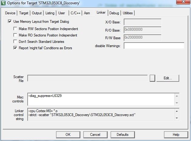

In the Linker Tab, I selected Use Memory Layout from Target Dialog.

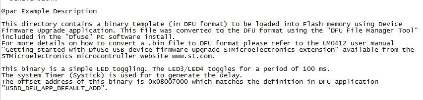

In the readme file of the dfu file provided by STM, it says the offset address is 0x08007000. The original description is as the picture shows below.

The part only has 64KB of flash (0x10000), you can't advance the address without shrinking the size an equal amount.
You'd want 0x08007000 with a size of 0x9000

I have changed the size of flash into 0x9000 or even smaller, but the same error occurs every time.

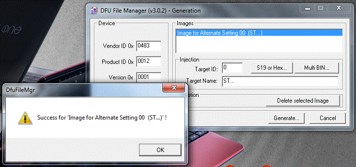

Now I am considering whether my DFU File Manager(v3.0.4) works correctly. Do you have a hex file that can be loaded in DFU File Manager(v3.0.4) correctly? Could you attach me the file to test if my DFU File Manager works fine on my computer?
Thank you!
Posted on December 03, 2014 at 05:11
I have 3.0.2, loading a different version would be too disruptive

My DFU File Manager doesn't work. I downloaded an old version which is 3.0.0, and everything now works fine.
