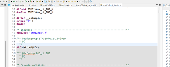

I noticed that the internal calls to the RCC may be ignored :crossed_fingers: as the IDE shows the intermost LL calls being greyed out. especially in the
#include "stm32n6xx_ll_bus.h" file

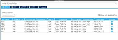

Did you configured the DCMIPP GPIOs correctly?
Kamurasi-Jordan-Arthur
Thank you so much for your reply, @Ch_JE.
:thinking_face:I am not aware of any GPIO to be configured for CSI interface except for the CAM_NRST and EN_MODULE pins, I have been under the impression the MCU's interconnect does not provide / require for this configuration for tbe manually made.
That said am glad to catch wind of this,
Attached are is the screen shoot for my GPIO configuration.
