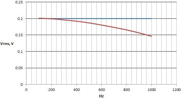

I tried to use CMSIS DSP library for FFT implementation on STM32F407. I based my project on Tilen MaJerle library.
I sample data with on board ADC and fill the input buffer with function TM_FFT_AddToBuffer(TM_FFT_F32_t* FFT, float32_t sampleValue). Hereafter I process data with function TM_FFT_Process_F32(TM_FFT_F32_t* FFT).

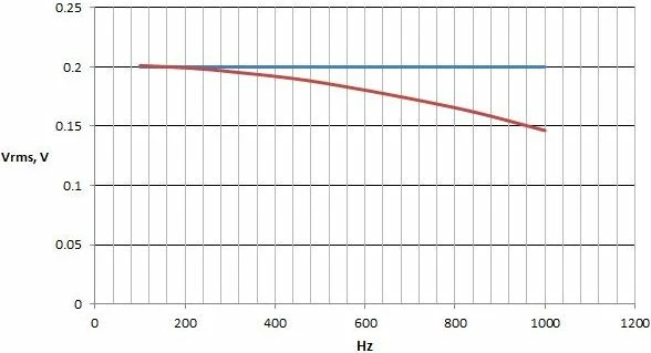

My problem is magnitude calculation accuracy. My task expects to get accurate level calculations of predetermined harmonics. I measure clear sinusoidal AC signal with DC offset on the ADC input with voltmeter. Then I measure the signal frequency with FFT lib and get the signal level degradation with the frequency increase. I take into account restrictions regarding the maximum measured frequency for the given sampling rate and that fact, I can't use more than 4096 samples with CMSIS DSP FFT.
I also need small frequency step, e.g., 1 Hz for the range between 100 and 1000 Hz.
There I show you the results. Blue line is measured with AC voltmeter. Red line is my measurements with FFT library. Sampling rate 4096 Hz, number of samples – 4096. By the way, the frequency is measured with some error. 100 Hz is defined as 101Hz, 800 Hz – as 808Hz. But this doesn't confuse me much.
The same picture is attained for other frequency ranges and sampling rates.
Now I see the only head-on decision is to mathematically adjust my results to real measured values. But this is not an elegant solution. It's highly likely that I neglect some important features of DSP FFT analysis and lack understanding of the math algorithm.
Other FFT realizations are not so clear to me. And does it really make sense to use other libs, for example, kissFFT and so on? Who has proven experience with other libs and would be kind to share his view with me? Any piece of advice is highly appreciated.

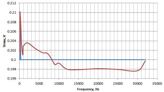

Dear friends. Thanks a lot for your answers. But at last I struggled my issue myself:grinning_face: And about half a year it took me to sit down and write about the solution here.
For my own part, it was quite a negligent misconception of how FFT works. There is a feature consisting in that fact that the energy of the given signal is spread between the given frequency and some nearby frequencies. So if we take the magnitude of the signal at the given frequency from the results of DSP library Fourier calculation, of course, we’ll get the signal loss which increases with increase of the operating frequency at the given sample rate. But if we take the root mean square value of the magnitudes of the given frequency and of some nearby frequencies, we’ll get no signal loss.
I studied DSP accuracy capabilities in practice – for different sample rates and for the range of frequencies between 30 Hz and 32 kHz. There is a calculable frequency dispersion in which we should calculate our signal magnitude as a root mean square value of the magnitudes of the frequencies inside the dispersion. And there is a calculable frequency definition error. The higher the sample rate, the farther is the calculated value of the signal frequency. By the calculated signal frequency we mean the frequency for which we see the magnitude maximum (when observing a clear sinusoidal signal). But the frequency shift is predictable and doesn’t make any problem. The more important property is signal spreading. If we take it into account and calculate the signal magnitude more thoroughly it will give us excellent results. Mine are that now my calculations finely coincide with voltmeter GVT-measurements in dBm. The difference is not more than 2% in the range of -40 … +22 dBm, for frequencies (30Hz…32kHz).
Here there're some results of magnitude calculation via a wide frequency range with voltage level 0,2Vrms. Blue line is measured with AC voltmeter. Red line is my measurements with FFT library. Number of samples – 4096 and sampling rate differs for special frequency sub-ranges. It is 4096 Hz for F=(30…1024)Hz, 20480 Hz for F=(1024…4096)Hz, 40960 Hz for F=(4096…8192)Hz and 81920 Hz for F=(8192…32000)Hz. As you see, the results are very satisfying.
I believe that for the people who are at their best with mathematical basics of Fourier transform my case is quite a simple task. But maybe I didn’t get the basics at once and too much reckoned on the DSP library calculation capabilities, so I’ve lost some time and nerve resources on the issue described. But now it’s OK and I’m deeply satisfied with DSP FFT realization.
