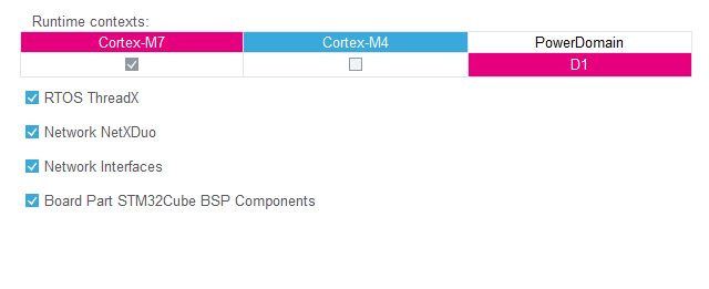

I have used STM32cube to generate the project with below configuration:

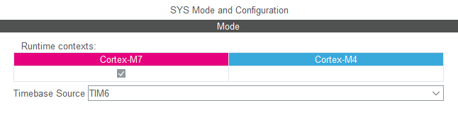

Change Timebase to TIM6

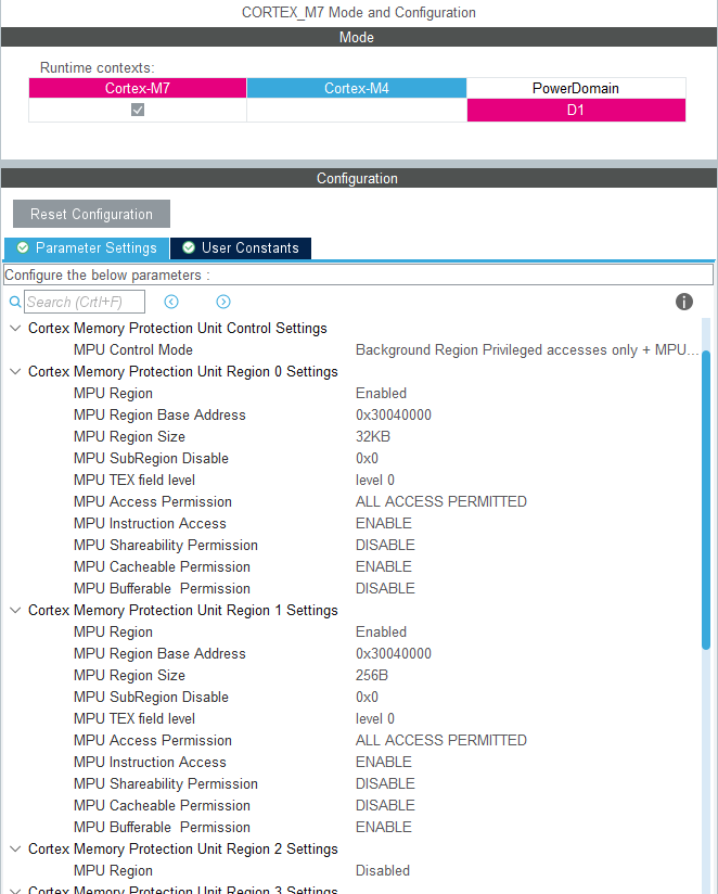

Setup the MPU and enable D and I Cache
Selected below middleware
0693W00000GVscRQAT.pngChanged the linker script
     .tcp_sec (NOLOAD) : {
    . = ABSOLUTE(0x30040000);
    *(.RxDecripSection)
    . = ABSOLUTE(0x30040060);
    *(.TxDecripSection)
  } >RAM_D2 AT> FLASH
.nx_data 0x30040200 (NOLOAD):
   *(.NetXPoolSection)
 } >RAM_D2 AT >FLASH
