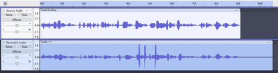

Hello @FBL
The first track is what's being played, and the second track is what's recorded out of the headphone jack.
  • Notice between 4-5 seconds, the audio is distorted
  • Not obvious in the recording, but once playback is complete, there's a low frequency hum (sounds like cat purring) that's very audible in the headphone from my side. (between 9-10 seconds)
