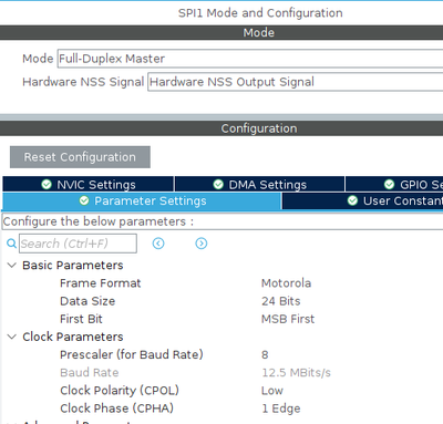

Ok, ADC msb first - you can set this in SPI parameters , like this:
ADC:
Should work.

I do have MSB set in the SPI but that is the bit order.  When I tried setting the SPI word length to 24, I got an error with the DMA using the FIFO.  I disabled the FIFO and got the configuration errors to go away.  Data was shifted out on the SPI but no change to the byte order.  Something to be aware of, I'm using a byte array and manually packing the 24 bit values into ie 3 bytes into the array.  I'm using HAL_SPI_TransmitReceive_DMA to transmit and receive the response. I'm not sure the DMA understand 24 bit word lengths.
I tried the CPU based blocking HAL SPI call to see if acts differently with 24 bits SPI length set.  Using a logic analyzer and looping the transmit into the receive, the bytes receives seem to be trying to be written as 4 byte integers (I speculate).  I'm sending out 0, 1, 2, 3, 4, 5, and so on. I see that as expected. I'm getting back 0, 0, 1, 2, 0, 4, 5, 6 and so on. With DMA, I'm seeing the output echoed back exactly.

Thanks. I think I see the direction to head. Looking at HAL_SPI_TransmitReceive, SPI word sizes >16 are expected to be in be uint32_t. Lengths 9 through 16 through in uint16_t and 8 bits or lower are uint8_t. This makes sense. I expect DMA will need similar size configuration.
I was planning on doing any processing with 32 bit integers as well. It looks like 24bit SPI words will be handled as 32 bit integers which is what I want.
tec683
To summarize, the variable size depends on the SPI word length.  For 4 thru 8, a byte is expected.  For 9 thru 16, a short (16b int) is expected, and for 17 thru 32, a 32b integer is expected.  The SPI peripheral will use the defined number of bits when transmitting.  The receive will accept the defined number of serial bits and present them as a byte, short, or integer as appropriate.  The DMA data alignment should be configured as the previous sizes.
This also handles the bit and byte ordering.
Another thing of note, the HAL_SPI transfer functions size argument really seems more appropriate to be count. It defines the number of SPI data length transactions to transfer from the buffer. For example, if you are transferring 6 SPI words of 24 bits each, the buffer is 6 integers while the size would seem to be 24 bytes.  These routines expect 6 in this case.
There does not seem to be the option to sign extend the 24 bit SPI word that is written to the 32 bit integer. I could not find anything in the reference manual. So it seems signed values would require some additional processing.
