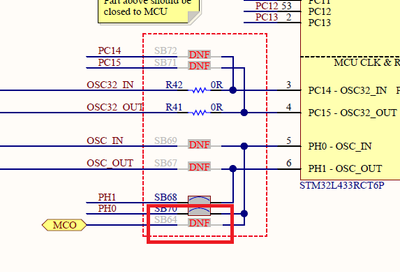

The board modifications are below:
- fitted X2
- fitted C47 and C48
- connected solder bridges SB67 and SB69
- disconnected solder bridges SB68 and SB70

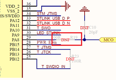

Except for STLINK-V3, you configure the STLINK  to generate the MCO signal from the crystal using STM32CubeProgrammer STLINK updater tool. Which is not the case for NUCLEO-L433.
@freeflyer Why you need to add a crystal while you can retrieve the precise clock (8MHz) from ST-LINK-V2?
But for that you need to:
1-  Solder: SB64:
2- Solder R19: you can put  0 ohm
3- Configure the HSE in Bypass mode in CubeMx.

@Andrew Neil Not on L4 boards - disconnected by default.
