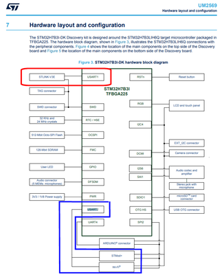

The Console, on a PC connected too the ST-LINK VCP?
If that's physically connected to USART1 you're not going to see interactions on USART2 connected to a WiFi module.
If you want to interact with that on the PC you'll need to forward back and forth between USART1 and USART2 in your code.
I am using option in the console Command Shell Console and it is configured just as settings of the USART2 (port, baud rate, data bits, stop bits and parity) and it could be used for any usart probably..
To be clear, I have disabled USART1 and only enabled USART2 to communicate...
Yes, it can be used for any USART - but how have you physically connected USART2 from your target system to this Command Shell Console  on your computer?
That doesn't clarify anything at all.
Enabling USART2 to communicate will not provide any connection from that USART to the PC.
How do you make the physical connection from USART2 to the PC?
EDIT:
As you can see from the User Manual, USART1 is connected to the ST-Link (Red), but USART2 is not (Blue):
So you're going to need to make some other arrangement to get the signals from USART2 to the PC ...
Ok, but how that's supposed to magically connect?
To get data out of the ST-LINK's VCP you're going to have to enable both USART1 and USART2, and then in the crudest implementation, sit in a loop checking the receive status of each, and moving data from one to the other

Isn't that equivalent to having a light bulb (console) connected to wall switch 1 (UART1), but you've decide to disconnect switch 1 from the light bulb and install switch 2 (UART2) without physically connecting it to the light bulb?
