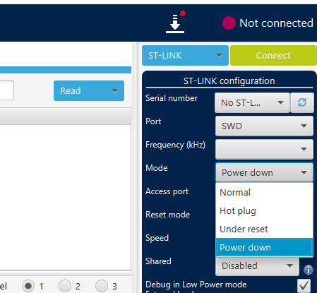

  • Did you do the STlink configuration Mode raindance?
0693W00000YAFdEQAX.pngCheck all posibilities.

I've tried right now other modes. Normal is the one of my post, hotplug has the same errors but the current doesn't change, under reset same errors & also current drop to almost 0, finally power down doesn't react at all "No STM32 target found!" at all times.
This is the ST-LINK configuration I've been using until now:
MM..1
Chief III
Disconect power from your board
connect stlink start in power down mode
click connect
plug power to board

Can you please expand on that? If I tri to connect with the board disconnected from power and then I try to "connect" with ST-LINK in power down mode I just get the message "No STM32 target found!"
