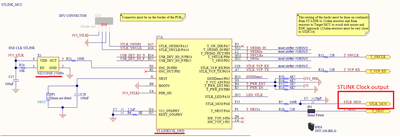

@sameer_2k3 wrote:
on NUCLEO-H753ZI board (MB1364), the STLINK has a crystal oscillator having a value of 25 MHz.
 How to use STLINK-V3 MCO output on Nucleo boards as a precise clock source for STM32 they already mention
It is used by the MCU that manages the STLINK (STM32F723). Not the target MCU, in your case STM32H753ZI:
STLINK is clocked by a 25MHz crystal oscillator and it generates another clock to the target MCU that should be configured in Bypass mode unless you added a 25MHz on OSC_IN/OSC_OUT.
PS: the STLINK clock output is configurable based on the article link provided above. So need to check what clock frequency is generating.

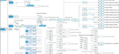

yess i have change PLL setting
after selecting 'Bypass' mode still the log is garbage

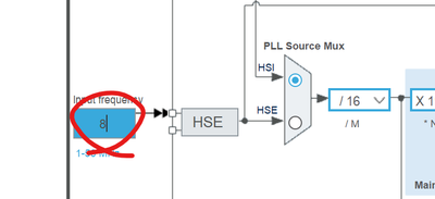

Did you change the HSE frequency in the clock tree to 8 MHz?

I configured the PLL to 400 MHz, and when I select HSI as the clock source for UART, the UART logs print correctly. However, when I switch the UART clock source to the PLL in CubeMX, the UART output becomes corrupted and prints garbage characters.
Why does this happen, and how can I fix it?
What changes do I need to make to use the PLL clock for UART logging without getting garbage output?
You still have the input frequency set at 25MHz :
You can use the MCO output to check actual clock frequency (the output pin will need to be configured for High speed)
