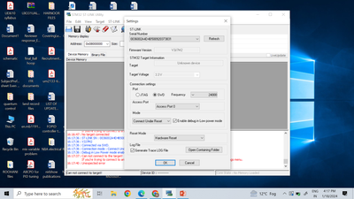

what is the process to"connect under reset"?
Try connecting the BOOT pin to VDD.
how it is to be done, is there any jumper setting?

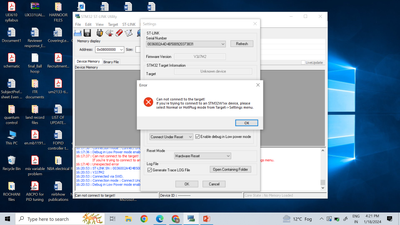

i've tried the suggestion  "connect under reset" as follows
but it is not working following msg is generated
Imen.D
Hi @NSing.5
I recommend you use latest release of STM32CubeProgrammer, instead of ST-LINK Utility.
Please follow this article that may help you: Unable to connect to STM32H7 devices - STMicroelectronics Community.
Thanks
Imen

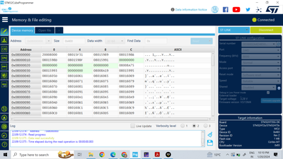

sir,
as suggested i've used STM32cube programmer.
Now the board is connecting to STM32cube programmer. it is reading memeory and other stuff from the board.
i've not erased the memory or programmed it from STM32cube programmer.
But still when i try to program it from IAR workbench, it is unable to program the board.
