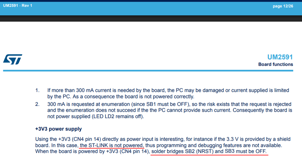

@KPN1 wrote:
the ST-Link connection is likely what is holding the reset down and stopping the micro from running.
Yes, that would be the case.
https://community.st.com/t5/stm32-mcus-boards-and-hardware/external-powering-of-nucleo-l031k6-hsi-able-to-run/m-p/663084/highlight/true#M18423
You should break SB2 to disconnect the Reset connection to the ST-Link;
Possibly also SB3 - to disconnect the VCP:
Thanks Andrew,
I did see that comment, although it only seems to apply when powering from the 3V3 pin. Even then it does not make sense looking at the schematic. SB2 is the reset of the STLink MCU and SB3 one of the comms lines to the USB. The design and the manual have drifted apart somehow.
From the MB1455C schematic I can see that the T_NRST (reset from U2 / STM32G031K8 / target MCU) goes directly to the PB0 of the STLink MCU. So the port protection diodes in U7 will hold the line down (to one diode drop) unless the STLink section is powered. That is exactly what I am seeing.
The least invasive solution is still to power the STLink part, since I can't easily disconnect it from the target.
Regards, Peter
Indeed, the manual does seem misleading/unhelpful in that respect.
But it will apply in any situation where the ST-Link is not powered.
Hmmm ... so they do!
Perhaps @STOne-32 could look into these documentation issues ...

@KPN1 wrote:
In some older boards you could break the STLink section off,
Indeed - that's what I always recommend as the surest way to have the ST-Link disconnected.
On this board, you should have the SB2 & SB3 links to achieve that - but it seems to have got messed-up somehow.
