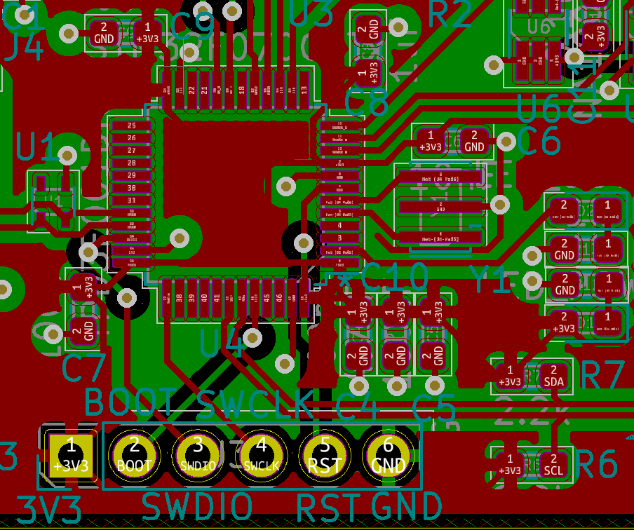

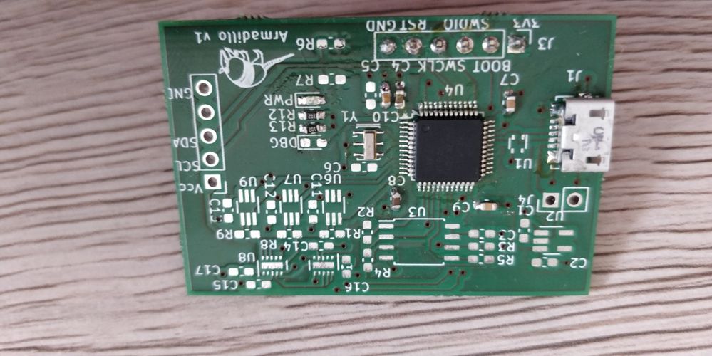

I've made a custom design of a board with an STM32F070C6B6. When powering on the board and connecting a genuine ST-LINK v2 programmer, the connection fails halfway through the setup.
What i've tried (i'm on linux):
1) Via STM32CubeProgrammer:
Connect under reset & core reset: the connection fails with either "DEV_CONNECT_ERR" or "DEV_TARGET_CMD_ERR"
2) Via OpenOCD:
`openocd -f interface/stlink-v2.cfg -c "reset_config srst_only srst_nogate connect_assert_srst" -f target/stm32f0x.cfg --debug` : The connection succeeds, but the chip does not respond to "halt" or "flash banks mass_erase".
3) St-link tools: Tool can connect but says "unknown chip"
Any idea's what could cause this?
Attached are a picture of the board and the pcb layout.

Hi, thanks for looking into this. The power good LED stays constant bright the entire time so i would doubt that the power supply is a big issue (feeding of a bench power supply). The part is factory new so bad code also shouldn't be a problem.
I'm not sure in what direction to look then, it could be my st-link v2 that's faulty somehow. The errors that I'm getting ("DEV_CONNECT_ERR") seem to indicate that the communication is working, but the chip somehow returns wrong values..

Well, do the Murphy's law check:
- Use multimeter and probe the important debug and reset pin with voltage measure and protection diod check (to make sure connection is ok)
- Check after power on that all supply pins and grounds looks ok. What is the MCU supply voltage in this application? 3.3V or 1.8 or..
- What is the max current of the regulator? Any voltage droops (invisible to LED)?
- Use a scope on SWD/SWCLK to look at signal shape.
- Make sure the footprint is ok and not mirrored/flipped (as with connectors, it's common to make PCB with flipped pins, top view, bottom view...)
