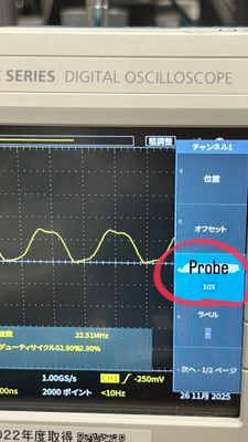

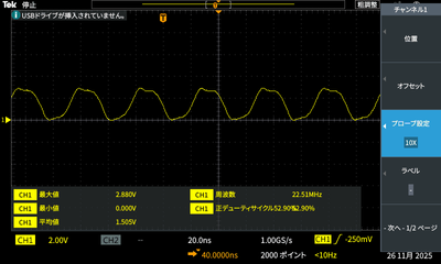

  1. I set the pin speed to "Very High" for PF6.

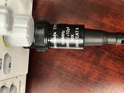

  2. I am using a 10:1 probe as shown in Fig. 2.
  3. The probe is correctly set to 10:1, as in Fig. 3.
I also disconnected everything related to the MT9M001 module.
However, the maximum voltage still does not reach 3.3 V.
 Fig.1 Wave of PF6
Fig.2 Probe
 Fig.3 Probe setting
Right, but thats fine now. Your probe loads > 12PF to the pin, at 22MHz this is about 800 ohms , so you cannot expect it better.
Try a high speed signal generator, if you have, and check its output at 20MHz, 0...3 V ;
to see, what your probe and scope can show at all here !
Because probe (and scope?) is 100MHz type, so looking at a 22MHz square, you can see 3. harmonic good, 5. harmonic is 22x5= 110 Mhz and will show still, but reduced level; and all higher harmonics your scope cannot show.
So all you can see from a perfect 22M square wave, is what you see now. (on 100M scope).
here 3. + 5. :

... and do not use the 10 cm GND connector of the probe. Use a spring tip for GND instead.
And check the scope's bandwidth. Should be at least 10 x of max signal frequency to see something close to a square wave.

... wait: I thought these x10 probes have usually some adjustable capacitive compensation for the divider and input capacitance, so unless your scope's bandwidth is the limit, 22 MHz should look better. At least if the probe's properly adjusted.
Alright.
I will check the probe calibration next week, so please wait until then.
I adjusted the probe compensation as you suggested, but the waveform still did not change.
