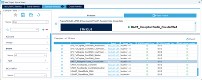

From where I can get existing example?
Yes I was able to get using basic HAL_UART_Transmit.
I will check the examples. Thanks @Andrew Neil.
Using the Example Selector in STM32CubeMX is probably the easiest way. Here is a relevant example:
