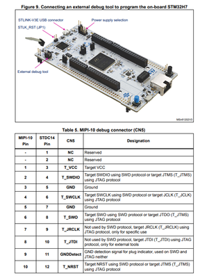

I had debugged my Nucleo board with the J Link with the segger RTT. Now i like to change to STLINK So l would like to know what version of ST external debuger support my board which can be used for debuging my device
You can connect a J-LINK on CN5 connector on NUCLEO H753ZI:
Please refer to the user manual of the board UM2407 / section 7.3.3 Using an external debug tool to program and debug the on-board STM32H7
For STLINK you can use the external version STLINK-V3 (I don't know what the reason to use an external version while there is one on board)
Hope that does answer your question

Thank you @mƎALLEm  The thing is i had tryied to debug using the internal debugger to print the debugging messages by refering this vedio but i couldn't see the any debug messages so i wanted to try the external STLINK.Can you please proveide any documentation on debuging with the internal STLINK
This is to use a printf over the serial wire viewer
You can refer to this article: Using the ITM console for printf redirects and LWIP debug messages
