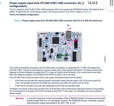

Just got a new Nucleo-H563ZI board and I was trying to connect it to PC through the STLINK USB-C port, in order to play with it. I've checked jumper config, and all seems right, but the only thing happening when plugging in is that LD4 RED half is always on and the green half blinks. No other LED is on.
If I change JP2 to power from CN13, plugging the same cable in the CN13 powers the board correctly, and the default demo starts running.

If you are sure about your USB cable (is a data cable and not a charging cable) and USB ports, i suggest you to try to connect your board to CubeMX using different connexion modes (under reset SW and HW, hot plug,...). You could also check the following part of the UM3115:

No, I can't connect to it when plugging the USB cable in CN1. The only LED that is on is LD4, which has the red half always lit and the green half blinking. From the PC side, nothing appears connected in that port, so I can't use CubeIDE or the firmware updater. I tried almost all of my PC and laptop USB port, and none works. All jumpers seem to be in the correct position.

The cable is good - with the same cable in the same PC port, if I change JP2 to USB USER and connect the cable to CN13, the board powers ok up and starts the demo preloaded firmware. Tomorrow I'll try to power up the board through CN13 and connect it to the PC with another cable through CN1.
Update:
Starting to doubt my new cable, I borrowed a old USB-C data cable for Samsung phones aaand.. it works!
So, I have a USB cable which was marketed as data and charging, but apparently the data part is to be debated :)
The weird thing is that I've used it for data connection with other gizmos and it worked.
