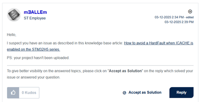

mƎALLEm
I suspect you have an issue as described in this knowledge base article: How to avoid a HardFault when ICACHE is enabled on the STM32H5 series
PS: your project hasn't been uploaded.

Thanks for your support. i am able to get temperature after mpu config. it is not calibrate
Please help to calibrate the temperature.
