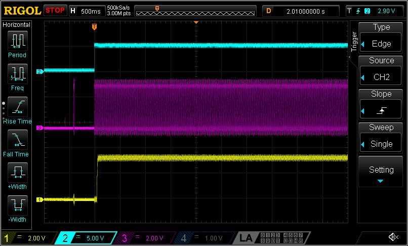

I am experiencing a bug in the ST-Link FW V2.J37.M26
setup
Nucleo-F446RE power from E5V

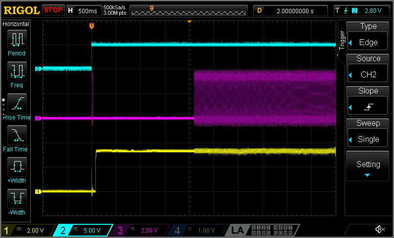

it takes a long time to "boot" or start to execute code. some code will never start running. the problem goes away if the ST-Link is power from USB before E5V is turn on
I have captured the problem on the scope. The MCO clock from ST-Link stops for about 2sek when power from E5V.
Nucleo-F446RE power from E5V ST-Link FW V2.J37.M26
Blu E5V
Yellow T_NRST
Pink MCO

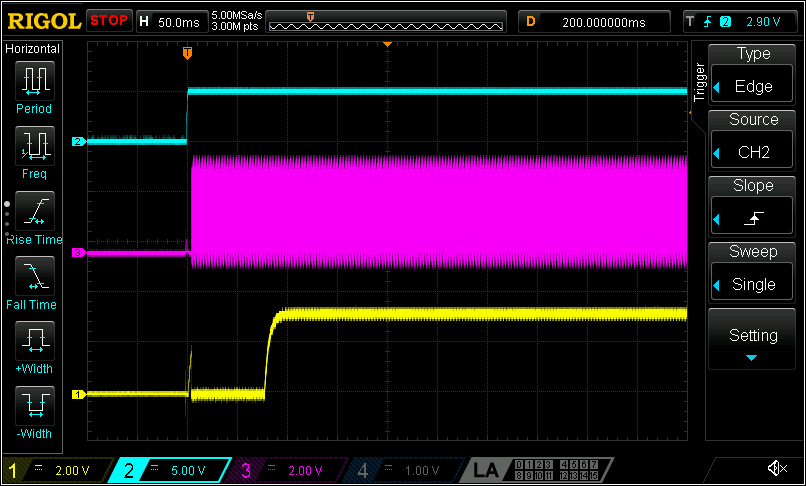

Nucleo-F446RE power from E5V ST-Link FW V2.J34.M25
Blu E5V
Yellow T_NRST
Pink MCO
Note the the time division is different
The following FW versions are bug free
V2.J33.M25
V2.J34.M25
V2.J35.M26
