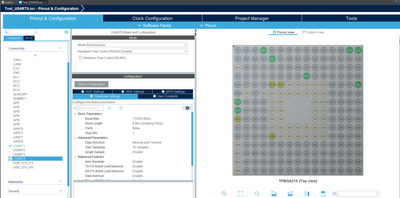

I am currently working on enabling USART6 for data transmission on my STM32F7508-DK board, but I have been unsuccessful so far. I have checked the datasheet for the correct RX and TX pin configurations, and I have tried two different pin combinations:
- PG9 for USART6_RX and PG14 for USART6_TX
- PC6 for USART6_TX and PC7 for USART6_RX
When I use USART1, everything works perfectly, but I need USART1 for other tasks, so I am planning to use USART6 for terminal output.

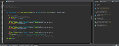

‎2024-12-10 7:11 AM - edited ‎2024-12-10 7:19 AM
Thank you for your response.
I tried to test a simple communication setup to send a message to the terminal. I followed the datasheet to configure the pins, but the USART6 still doesn't work. To debug the issue, I created a small test function that uses USART1 (which I know works reliably) to print potential error messages. This way, I could identify what might be going wrong with USART6.
Attached, you'll find a screenshot of the terminal output and the function I used to diagnose the issue.

‎2024-12-11 3:09 AM
Thank you so much for your explanation! Following your advice, I successfully connected USART6 to the D1/D0 pins on the Arduino shield, which allowed me to establish communication via USART6 and start printing to the terminal. Everything is working as expected now!
