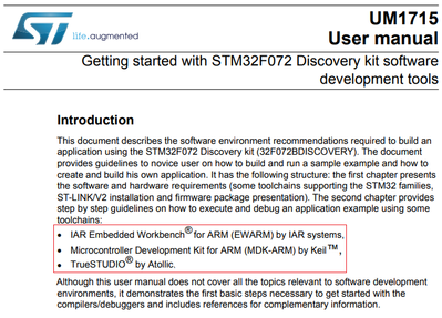

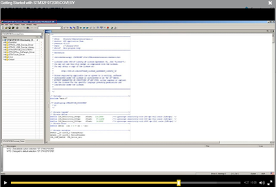

As per the 'Getting Started with STM32F072DISCOVERY' video and the UM1715 User manual, the software development tools mentioned are IAR Embedded Workbench, Microcontroller Development Kit for ARM (MDK-ARM) by Keil, and TrueSTUDIO by Atollic.
Could you please inform me if the board is compatible with the ST Development tools such as STM32CubeMX and STM32CubeIDE? Could you kindly assist in identifying the IDE and SDK, along with a sample application, in order to kickstart the development process?

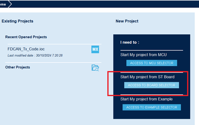

STM32CubeIDE and STM32CubeMx are compatible to all STM32 MCUs.
You can start from CubeMx and start a project based on the board:

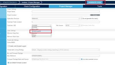

In the project manager tab, select the IDE and generate the code:

Hi @liaifat85, I really appreciate your helpful response to my question. The link you provided was instrumental in guiding me on how to kick off a project with STM32CubeIDE and STM32CubeMX. Thank you!
Hi @SofLit,
I really appreciate your help in resolving my question. I checked out the link you shared, and I was able to access the example projects. Everything worked perfectly, and I could verify it with my hardware. Thanks for your support!
