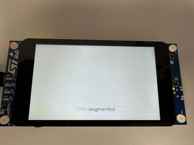

It looks like I have the 32F469IDISCOVERY board that looks to be powered ok via USB connector CN13, however the board doesn't appear to have demo software preloaded. COM LED LD6 flashes red.
I note on the ST website that there is the 32F469IDISCOVERY compiled demo binary, which I have downloaded.
The Readme says: The QSPI external flash loader is not integrated with supported toolchains, it ís only supported with
STM32 ST-Link Utility V3.7 or later.
But the ST website says that the ST-Link Utility is NRND and to use STM32CubeProg instead. I've tried the latest version of STM32CubeProg and it can't connect to the board via USB:
Error: Establishing connection with device failed.
What is the best way of programming the board with this file please?
Kind regards,
Al

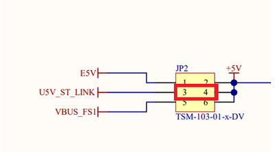

Ok thank you for the confirmation. So, check you have JP2 is at the position 3-4
Check your cable, is it a data cable or power cable?
Refer also to How to solve connection errors when connecting and programming the STM32 target board

Thanks for the suggestions, I'm using a Mac so don't need the ST-LINK drivers.
However swapping between several USB hubs and cables I found a combination that did work and I was able to program the board ok. However the demo is a bit underwhelming...
I'm guessing some of the third party assets weren't included in the build for the STM32469I-Disco_Demo_V1.2.0_FULL.hex binary.
Anyway the board works, which was the main point of the exercise.
