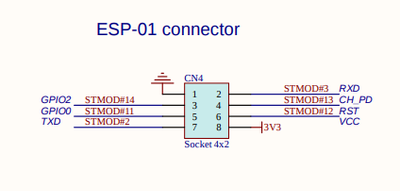

  • GPIO0 (ESP-01 pin 5) reads 0 V (GND) with a multimeter.
That explains it: GPIO0 = LOW at boot → ESP goes into flash/bootloader mode, so it won’t run AT firmware. The LED behavior also matches (LED stays on in flash mode).
Questions
  1. How is GPIO0 wired on the MB1280 at the ESP-01 socket? Is it tied to GND by default?
  2. Is there a jumper, DIP switch, or solder bridge on the MB1280 to change GPIO0 to HIGH at boot? If so, where is it located? (I couldn’t find it in UM2411.)
  3. If there’s no configurable option, is the recommended workaround simply to add a 10 kΩ pull-up from GPIO0 to 3.3 V?

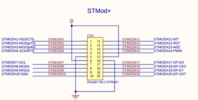

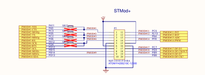

The GPIO0 connects to STMOD#11 (Pin 11) which is PC6 on the H747I-DISCO side
AScha.3
this ?
So seems on PC6 ; try set it hi...
