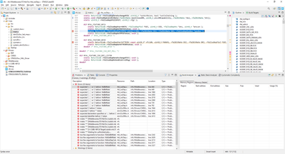

I'm trying to compile an STM32U599VJTX build containing the X-CUBE-NFC6 software pack to talk to an ST25R3916B on our prototype board but cannot get it to compile.
I get the following errors related to "rfal" files:

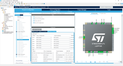

I believe the platform settings are ok:

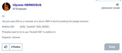

Ulysses HERNIOSUS
I think the reason is the STM32U599 having a DSI block and its HAL having a "#define DSI something".
Please check this. There was once a very similar request: compile-errors-importing-x-cube-nfc5-package
BR, Ulysses

Hi Ulysses,
Thanks for the response, I think you could be right, I applied your suggestion from the link you provided and now everything compiles error free.
Screenshot from your other ticket here in case anybody interested (basically use "#undef DSI" in platform.h. )
