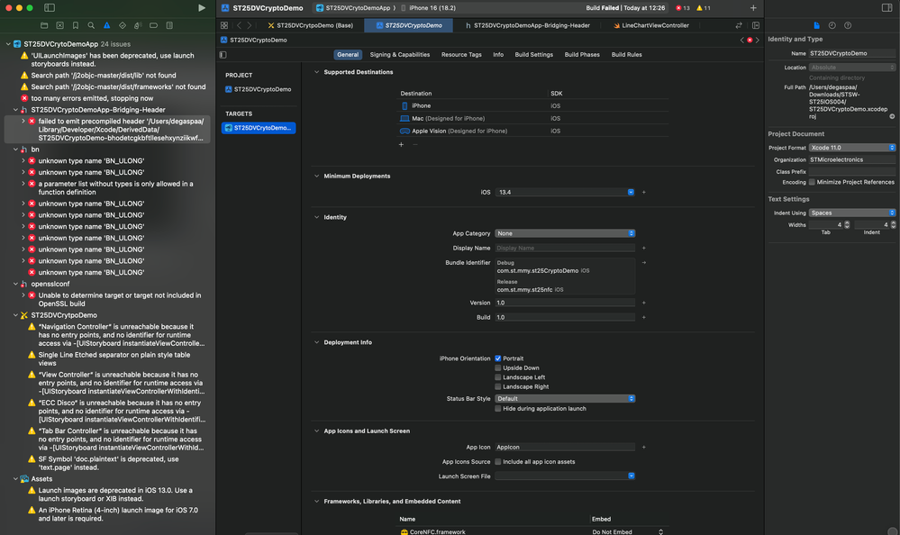

Hello @all,
I've downloaded ST25DVCryptoDemo for iOS from here, in order to take a look into the demo code for a new project.

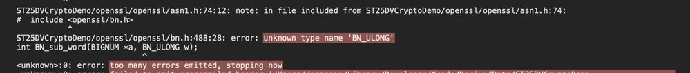

Once I've tried to build the Demo app I've got a big amount of errors. In fact the console gave me this message "too many errors emitted, stopping now"
Could someone please help me to fix those issues and make everything works properly?

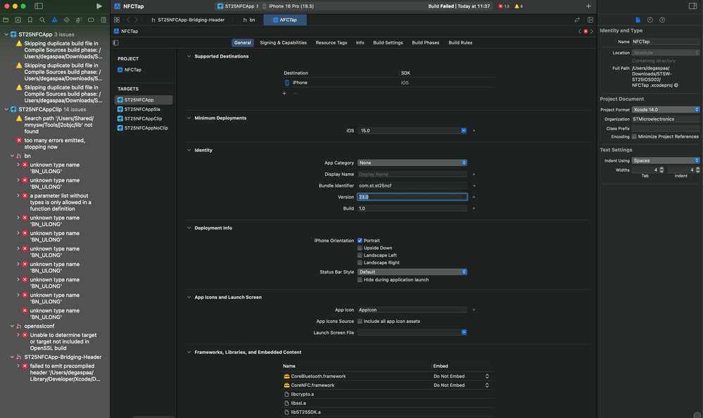

I've tried to do all the instructions that you posted in the other comment.
But it's not working.
I tried both for ST25DVCryptoDemo (version 1.0 build 1.0) and NFCTap (version 23.0 build 1.0).
I've downloaded the master version of J2ObjC.
Once the "make dist" finished to run I've copied and pasted the directory into ST25DVCryptoDemo and NFCTap.
Linked the references of j2ObjC in Build Settings.
Run clean and the build, but it's not working
