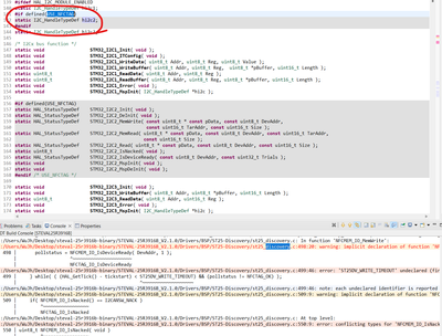

Hi BT
Thanks for your reply, in terms of FW, there are some errror occured after added the changes you suggested.
In your FW, hi2c2 only can be used in st25_discovery.c, and  USE_NFCTAG needs to be defined for enabling hi2c2 related code.
could you help to check? or the FW I am using is not the latest one?
Thanks
Leo
Hi Leo,
there was a typo in my previous answer: replace the spiInit(&hspi1); in the main by i2cInit(&hi2c2);
The I2C2 has to be initialized. This can be achieved by adding the proper MX_I2C2_Init() function inside the main.c file or by calling the BSP in the st25_discovery.c with the relevant define (in that case add  i2cInit(&hi2c2); before returning from STM32_I2C2_Init).
Also, make sure to enable the I2C2 even and I2C2 error interrupts.
Rgds
BT
Hi Brian,
I also need to define "USE_NFCTAG" for enabling STM32_I2C2_Init and I2C2 related functions, but some errors occured after I defined USE_NFCTAG in define symbols.
Could you help to run at your PC? I don't know if I am lacking some source files or not.
Thanks,
Leo

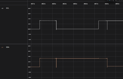

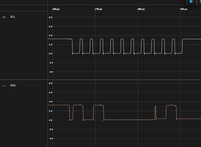

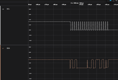

Hi Rene
Thanks for help, now FW can be compiled and programmed to the board sucessfully.
but now the program is stuck at "InitializeRFAL"function.
I checked I2C waveform, it looks like SCL pin will latch sometime, as below, do you have any idea?
Thanks,

Hi Rene
I have tried all of V_RF configuration, the result still remain the same, SCL latched during InitializeRFAL.
I will contuine to check where is the issue, but I also need your help to fix this issue as well.
Thanls,
Leo
Hi @LeoWu,
Is it possible for you to connect only the necessary signals to the daughter board. This would reduce it to I²C bus and power supply, avoiding any conflicts with other pins. On my side, I have tested the STEVAL board with I²C and it works correctly.
Kind regards.
