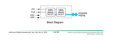

We are planning to use  PSRAM chip apmemory (APS12808L-3OBM) with STM32U575QII6.
Please check pin assignment from STM32 to PSRAM chip
And also please share the schematic and layout guidelines for STM32U575QII6 OCTASPI to PSRAM chip integration. And general layout guidelines.

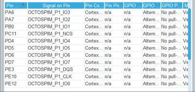

Hello @Pramod_Bangalore,
For Octo-SPI mode, ten GPIOs are needed, when one memory is connected. An additional GPIO for DQS is optional for the Regular-command protocol and mandatory for the HyperBus protocol.
According the memory datasheet the DQS is available and you can used.
For pin assignment you can use STM32CubeMX or you can refer to STM32U575 datasheet table 26.
