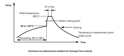

need information about the soldering profile for LQFP100 pin package in case, soldering the IC manually with temperature controlled soldering station

a soldering profile depends on the process for the used tin , not on the case of the parts.
So see the standard profile for your solder.
for RoHS, Pb free:

It seems max. temperature for soldering will be 260degC for manual process also on temperature controlled soldering station, then what could be temperature for de-soldering it?
as, during initial board bring up & trouble shooting , i would like to ensure that chip should not get damage during any process
same as soldering, but maybe somewhat higher, because chip anyway going to trash then.
So its more : not damage the board. I use 350° (hot air) for desoldering, or hot plate at 260°.
The chips/parts usually not very sensitive to high temp. , if its just for short time.
https://www.ablic.com/en/semicon/support/package/solder-temp-profile/
For hand soldering typical recommendation is:  Resistance to soldering heat 260 °C/ 5 s  . (for relais here)
And as always: important is the flux , good flux.   And the way, you do it...experience helping a lot.

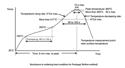

thanks, already went through document, but unable to get the required info.
October 24, 2025
The chips are not particularly sensitive or delicate. Heat them up until the solder melts, hold a couple seconds, then let them cool down.
If you want the best reliability, use the recommended reflow profiles.
