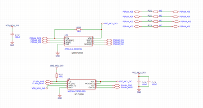

sudheesh_
Here is my current memory section. Please review it and let me know whether it’s correct or if any modifications are required.
