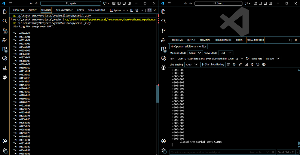

ERROR IN CIRUCULAR BUFFER TO TRANSMIT FROM LAPTOP TO CAN via PYSERIAL AND THEN RECIVEING AT PRINTING THE FRAMES ON ANOTHER STM32 ON SERIAL
tantheman
Code is given below in the files:

import serial
import time
# --------- Configure your COM port here ---------
PORT = "COM12"           # change if needed
BAUD = 115200
# timeout > 0  → blocking read with this max wait time (in seconds)
ser = serial.Serial(PORT, BAUD, timeout=0.05)   # 50 ms timeout is plenty
def format_frame(val: int) -> bytes:
    Convert integer val (0–256) into exactly 8 bytes:
    "+XYZ+XYZ" where XYZ is a zero-padded 3-digit number.
    return f"+{val:03d}+{val:03d}".encode("ascii")
print("Starting PWM sweep over UART...\n")
try:
    while True:
        # -------- INCREASE: 0 → 256 --------
        for pwm in range(0, 257):
            frame = format_frame(pwm)
            ser.write(frame)
            # Print what we sent
            print(f"TX: {frame.decode('ascii')}")
            # Optional: try to read back 8 bytes (if STM echoes)
            resp = ser.read(8)
            if resp:
                print(f"RX: {resp.decode(errors='ignore')}")
            time.sleep(0.01)   # 10 ms between frames
        # -------- DECREASE: 256 → 0 --------
        for pwm in range(256, -1, -1):
            ser.write(frame)
            resp = ser.read(8)
            if resp:
            time.sleep(0.01)
except KeyboardInterrupt:
    print("\nStopped by user.")
ser.close()
(PYSERIAL CODE)
THE
THE FIRST COMMAND KEEPS REPEATING ON THE CAN REICIEVER END...... IS THERE ANY LOGICAL ERROR OR CODE ERROR, PLEASE POINT IT OUT
1 REPLY 1
You'll have to debug your code to understand which points specifically are failing.
Perhaps use a debugger, and determine if your USART or CAN is actually functional. Just saying the PYSERIAL doesn't do what you want at the end, is a bit abstract, illustrate expectations and confirm each step can work.
I don't see rx_ready_flag ever being set.
