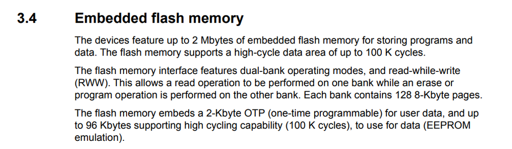

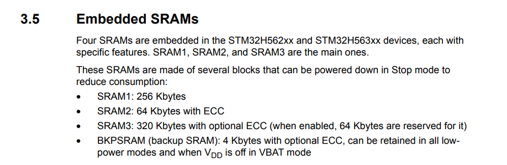

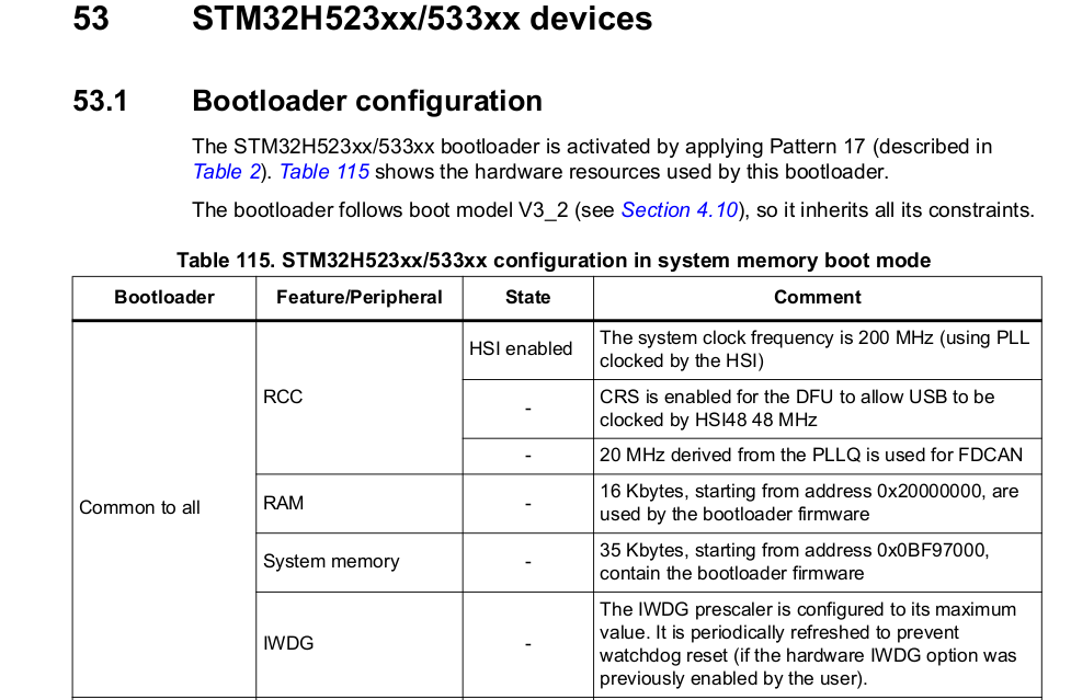

I would first like to know the exact values for the SRAM address range, FLASH address range, PPS, PSize, Option byte address range, System memory address range, and Flags items.
I expect you to inform me about this.
thanks,
nama
Dear all,
As you mentioned, using STM32CubeProgrammer would be ideal, but we need to control the STM32H MCU by integrating a flash programmer into the host.
Therefore, despite some potential issues, I believe we should use “stm32flash 0.7”.
Anyway, I have compiled the device information based on the contents of the following capture file and I successfully performed flash writing and verification.
However, for some reason, the STM32H MCU does not boot.
I suspect the settings below might be incorrect.
I need advice on whether these settings are correct.
SRAM-address-range : 0x20000000 ~ 0x20040000
FLASH-address-range : 0x08000000 ~ 0x08200000
PPS : 1
PSize : p_8k
Option-byte-addr-range : 0   // I couldn't find this information.
System-mem-addr-range Flags : 0x0BF97000 ~ 0x0BFA0000
Flags : 0
